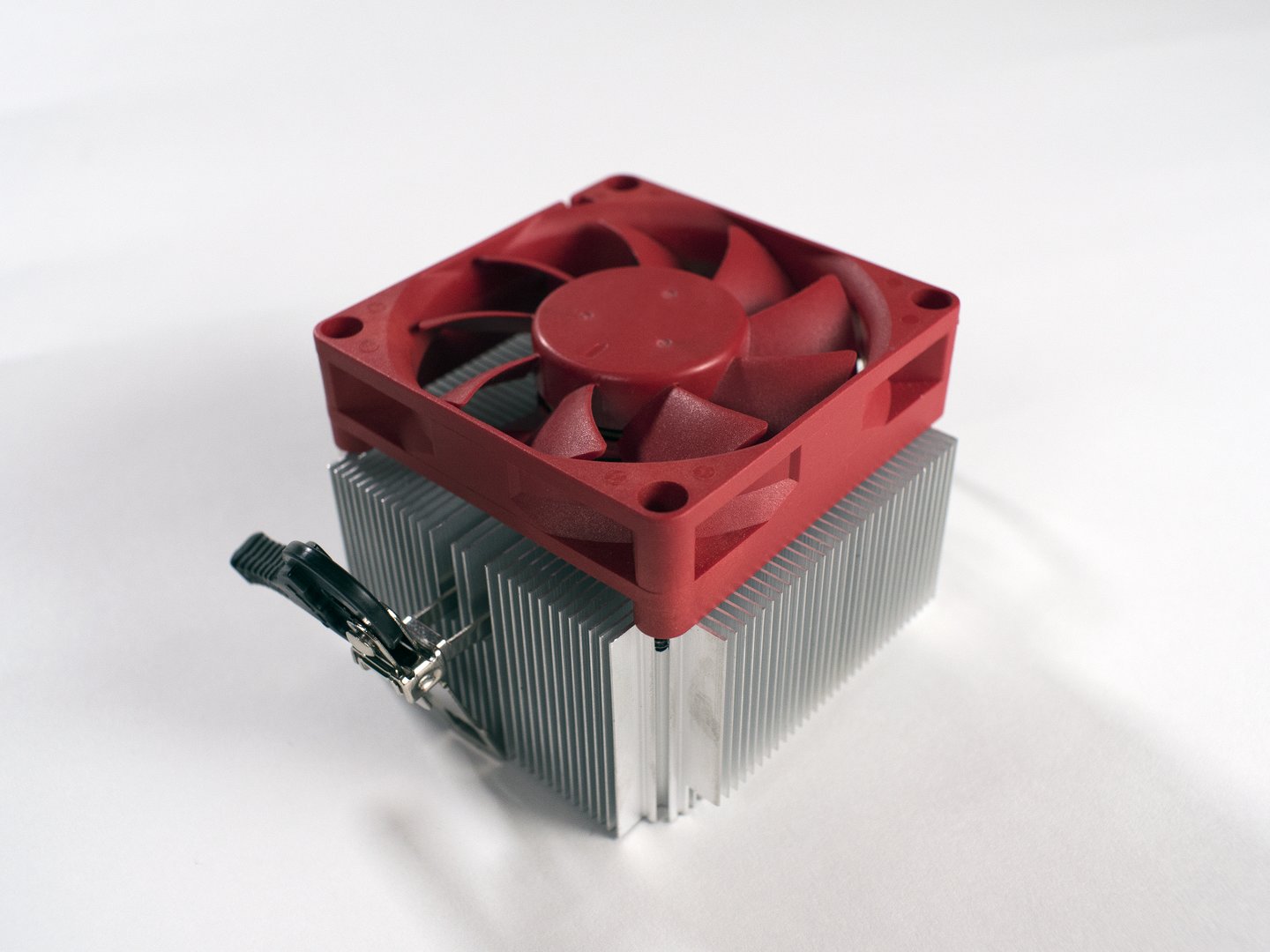

Heads up to anyone considering A10-7860K, according to reviews it comes with this cooler (shown below).
But mine came with the conventional (non-heatpipe) 58mm tall copper core 95W Quiet cooler (Same cooler as found on the Athlon x4 845).
The Stilt
Dec 5, 2015
1,709
3,057
They are both HS65 (95W) class heatsinks, from different supplier. The one with heatpipes is supplied by Coolermaster and the solid aluminum one is from AVC. You can get either, depending on the batch.
