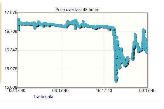

Looking over the last 24hrs of exchange data I do not see where it hit $1. Care to help me out?
It fell $1. As in dropped in value by $1.
It didn't fall TO $1.
