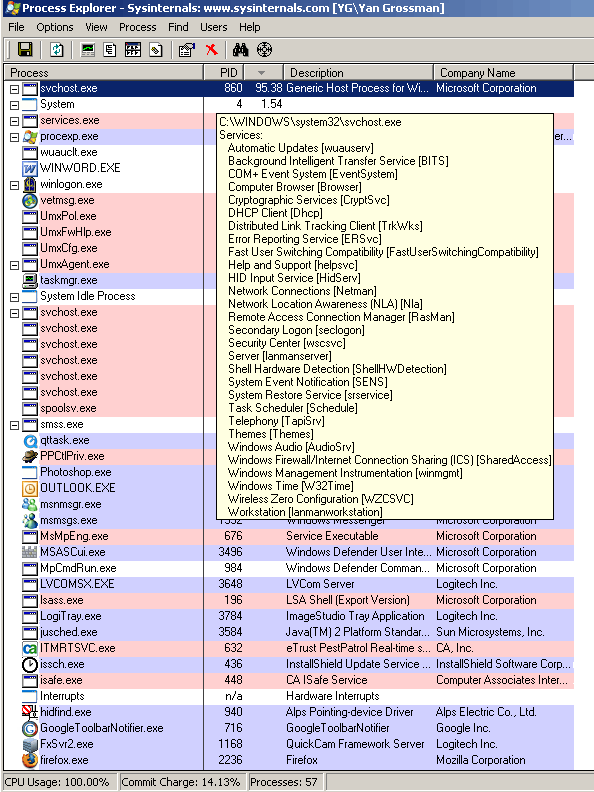

I can barely turn on the computer and the CPU starts running at 100% capacity. I really have not installed anything recently or made changes to the computer settings.
I see it's svchost taking all the CPU. I did run process explorer to see what services were running on that scvhost and apparently it's all the basic services that seems like I need.
I did take a screen shot but there is no way to attach it here. So I have uploaded to photobucket
http://i301.photobucket.com/al...skoooba/Untitled-1.gif
Would you please take a look and recommend what to do?
Thanks so much

sounds like you have gotten a virus id check it out and see...im sure that is what it is

Could have the problem where windows update is going crazy. Try disabling automativ updates and update notification.

I ran CA AV last night and it didn't find anything. I also made sure it has been updated. I also run anti-spyware and deleted them. I will check again today.
This is by far the most common root cause for this specific issue. I'd recomende trying this if AV / Anti SPyware scans comes up clean.
Usually you can also try booting to safe mode and see if it helps. If it does its one of the startup services / drivers / applications that starta during a normal boot. You could then proceed disabling them 5-6 at a time and then reboot and see if it helps, if not disable some more until you find the culprit.
