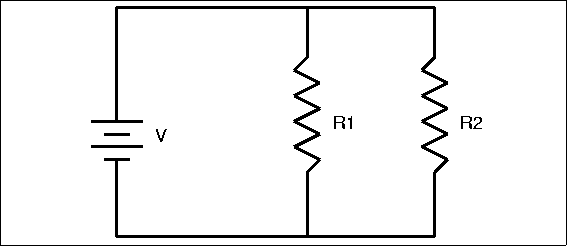

a) If you have room to increase voltage to achieve a higher current, you can do that, assuming resistance stays the same.
b) If you need a set voltage, then you can decrease resistance to give you increased current. Using a thicker wire would have this effect, though typically, anything substantial would require a very thick wire. Thicker wires are used because they can handle more current without heating up too much (current causes heat according to R * I^2) but this starts to get into the physics of it again. I can explain it though if you want.
Both of the above, however, assume a very, very basic circuit which would do essentially nothing for you in real life. There's actually all sorts of fun games you can play with circuits to manipulate voltage and current. A very basic example is if you put two identical resistors in parallel, both connected to a voltage source. This would split your current between the two resistor branches so that each branch receives half of the original current.
Now, if R2 is say, a light bulb (your load circuit), and before you hook up R1, you calculate that R2 has 0.1 amps of current going through it when connected to an ideal 10 V battery (with no internal resistance). You would then know that your load (light bulb) has a resistance of 100 ohms. Thus, by choosing R1 to be 100 ohms and placing it in parallel with R2 as shown above, you now have 0.1 / 2 = 0.05 amps running through your light bulb. By making R1 bigger or smaller, you can adjust the amount of current going through the light bulb theoretically from 0 amps (R1 is a wire with no resistance) to 0.1 amps (you make R1 infinite).

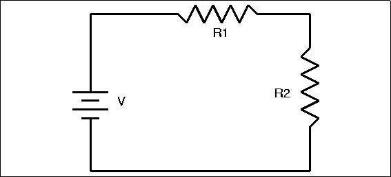

Following the same basic example, if you instead put the resistors in series:
Where R1 = R2, the voltage in the wire between R1 and R2 will be half of your voltage source. So, if you want to manipulate a voltage to be between 0 and your original voltage source, you can play with resistors to get any voltage drop you want (theoretically) by
V2 = V * (R2 / (R2 + R1)) where V is your original voltage and V2 is your voltage between R1 and R2.
Oh, I forgot, in the previous post, you get the current by:
I2 = I * (R1 / (R1 + R2)) where I is your originally measured current and I2 is the current going through R2.
Also note, both of the above examples would be a horrible voltage/current source, this is just to get the basics of V = I * R and how you can play with it.
