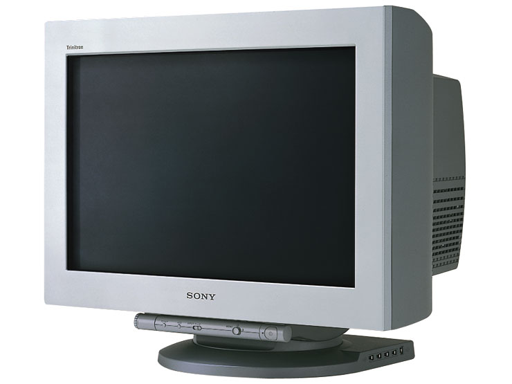

I went from this to this to this. Between faded whites/colours (CRTs lose 50%+ of their brightness over time), geometry distortion issues, fuzzy text, eye strain/headaches over extended daily use, and tiny CRT screen size, no proper height adjust, swivel or vertical pivot rotation, I do not miss my CRT days at all. Outside of twitch FPS gaming and deep black levels, CRT's limitations are just too high. I cannot imagine using a 19-23 CRT for productivity, movies, picture viewing and games in 2016 with so many amazing monitors that do both.
It's actually possible now to purchase a 27" 4K IPS monitor for about $500-550 US:
Dell Ultra HD 4k Monitor P2715Q 27-Inch Screen LED-Lit Monitor
And even a 27" 4K IPS + FreeSync:
LG Electronics MU67 27MU67 27" Screen LED-Lit Monitor
