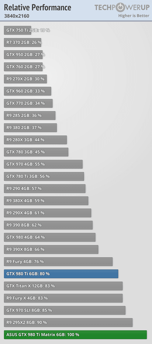

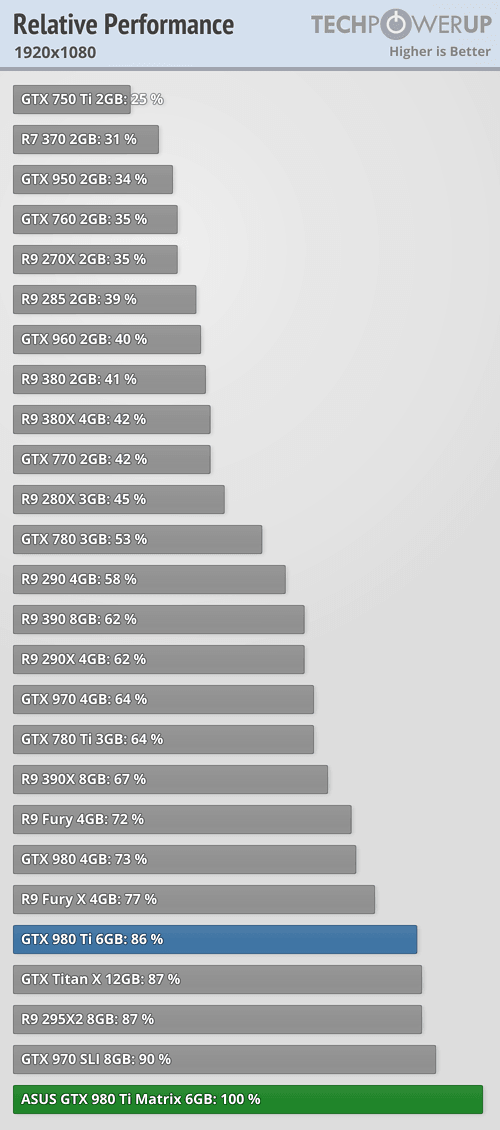

Thanks, I had the notion that the TI was on average 30-35% faster...
The 980 Ti does seem to overclock a fair bit better than the 980, so OC vs. OC the 30-35% span might hold true (although this is of course always hard to say with any level of certainty given the variability of overclocking).
