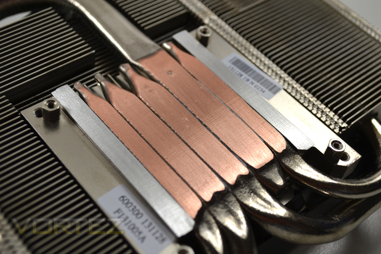

Do the heatpipes touch each other? In the picture from the earlier posting, it looks like there are lines/gaps between the pipes, so maybe that's what interfering with efficient heat transfer between the pipes and resulting in such bad numbers.
Also with heat pipes generally, what is the threshold temperature where the fluid inside the pipe will vaporize at the heat source? Maybe the gap between pipes prevents enough heat transfer to allow the warmest part of the heat pipe reach the threshold vaporization temperature (for those outer pipes that don't make direct contact), so the heatpipe is effectively neutered and instead of acting like an efficient heat pipe with vaporizing fluid, it's instead just acting like a boring metal heat conductor.

The pipes are flattened, so there appears to be a gap, but there actually isn't.

The pipes are pretty clearly well in contact with each other and with the block.
http://www.vortez.net/articles_file/25546_asus-r9-290-direct-cu-oc-directcu.jpg
There will be a temp gradient. The further away from the heat source, the lower temps are.
Thermodynamics work in such a way, that the heat pipe cannot get hotter than a threshold depending on the phase-change fluid used in the heatpipe, as long as there is a fluid to be vaporized in the heat pipe.
So, in order to have a heatpipe warmed to the temperature required for effective vaporization (boiling) to occur, you need to have a source of heat that can deliver the energy.
Energy will flow from higher temp body, to lower temp body, with a gradient dependent on the thermal conductivity (resistance).
The heatpipes that do not have direct contact with the die will work with very limited capability as long as the heatpipes with direct contact have some phase-change fluid in them to be vaporized.
After reaching the point where the heatpipes with direct contact can't handle the energy they will overheat, then enough heat will transfer through the metal layers of heatpipes, cooler base, solder, TIM etc, to other heatpipes without direct contact with the core to rise their temperature to the boiling point of the fuild.
There is a reason why we don't use metal rods instead of vapor based heatpipes. Phase-change cooling is much more effective.
