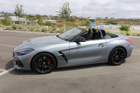

Livin’ the dream!
I just bought a fun toy myself. It is a bit more practical than a Lotus Elise. It’s a fun car and it is fast but not nearly as communicative as the Lotus is.
