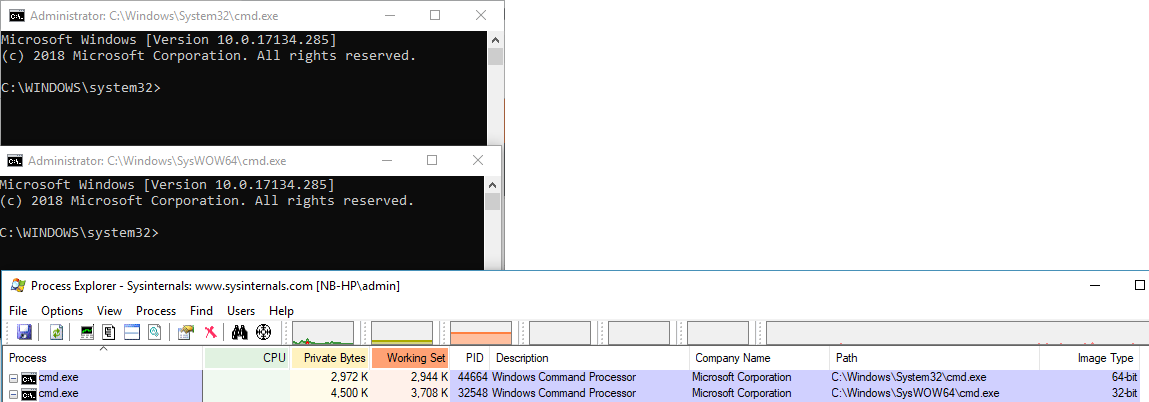

Interesting.
Either you launch cmd.exe from start menu or start cmd.exe from C:\Windows\SysWOW64 directory with adminstrative rights, both opened a console showing C:\Windows\system32 as the current directory.
