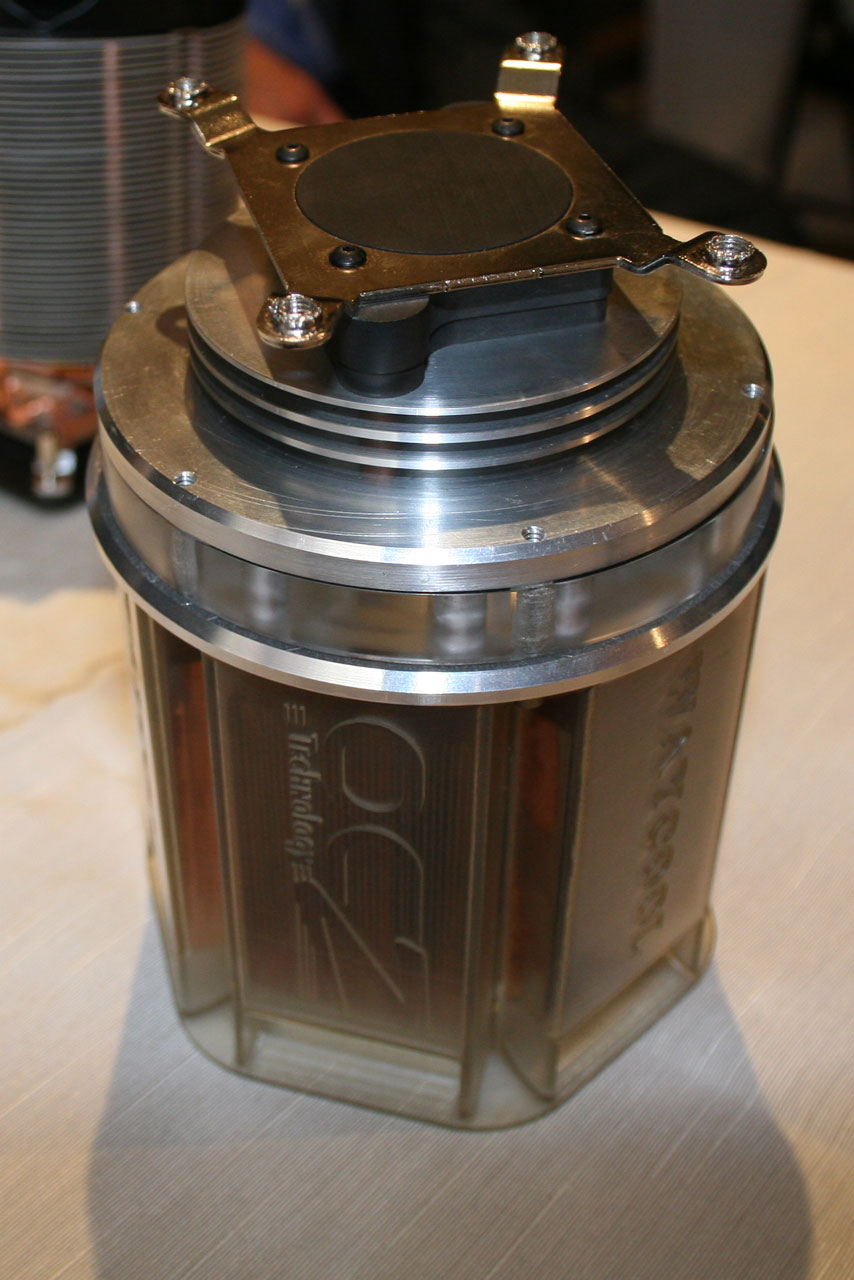

There is a lot of issues with Graphene.
OCZ has played with it. And Tony said these to me on XS after they were done with it.
Graphene is hydrophobic....
Graphene is extremely brittle
Graphene does not like to be bonded with metal, because again its very brittle.
So u cant even use water cooling for it with a radiator.
Throw heatpipes and fins on it without difficulty because it will shatter.
And if u drop it or add too much pressure on a small area, it will crack and shatter.
OCZ did a lot of experimentation with it.
The conclusion was its too much of a headache and profit loss to do anything with it.
A better solution is something like IC Cooling Pad.
Its not as great as a thermal paste, but it has amazing X axis transfer properties.
That means that little foot print die heat source can be spread out to a larger foot print, and then moved more efficiently.
Only problem again, the Y axis transfer is not as great as direct contact.
But again because of its X axis spread, it does get almost near results as basic thermal paste.

Wasn't it meant more as a replacement for silicon in chip production?
Yeah, but thermal properties of Graphene are also insane being i think 3000-5000W/mK.
Compare that to copper at 385W/mK, you can see why OCZ wanted to desperately make a heatsink out of it.
You cant just slap a graphene die over a copper IHS.
You would have a thermal runaway or a meltdown so to speak, basically the copper could not keep up with the graphene putting out, and would eventually melt the PCB, unless thermal throttle was in place, think back to AMD Duron cpus.
And Graphene is not anywhere near a room temp super conductor.
I recall Intel tried to work with graphene a while back ago, and they came to the conclusion it was just too difficult and expensive to make CPU dies out of them.
This is intel saying its too costly to make, back when they would dump millions on stupid experimental stuff just for prospecting case.
