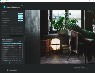

The delta between CPU and total system power is too high 30-35W 🤔🤔.It's reporting up to 60W, quite incredible 🙂

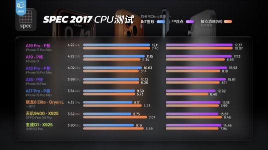

X925 performance per clock on SPECint 2017 is at M4 level so about 10% behind M5: https://blog.hjc.im/spec-cpu-2017The C1 Ultra scores in GB have quite a range (up to 34xx) but cluster around 3200, max clock right around the A19 Pro (4.21GHz vs 4.26GHz).
So we’ll call it 760 pts/GHz.
The X925 scores around 2700 at 3.63GHz. Or around 745 pts/GHz.
Whereas Apple increased from ~866 pts/GHz to ~905.
That result is the only one I’ve seen where it’s even that close, actually more.. unfortunately so far there is not a C1-Ultra result.X925 performance per clock on SPECint 2017 is at M4 level so about 10% behind M5: https://blog.hjc.im/spec-cpu-2017
As others said, PPC is not the issue, clock (and power) is.
They are NOT.But clocks are nearly the same for C1U and the A19P.
So what are they getting up to? Fine I’ll amend it, “reported clocks”.They are NOT.
Full stop.
They're not.That result is the only one I’ve seen where it’s even that close, actually more.. unfortunately so far there is not a C1-Ultra result.
And here is a different result, showing a much different picture from the mobile lens.
Clearly power is a different story. But clocks are nearly the same for C1U and the A19P.
These are phone devices, constraints are vastly different between various phone makers, both at the HW and the OS levels. We're in the Cinebench thread and I think laptop comparisons make more sense even though admittedly SPECint is a poor proxy for Cinebench 🙂And here is a different result, showing a much different picture from the mobile lens.
Interesting, that helps, I’d imagine the A19P is also dropping a bit as well. It’s not just going to pin at 4.26GHz. That’d be a good comparison point.They're not.

It's possible PSU, as 210W unit is not that efficient at 70-90W, then you have losses in internal power circuit and I think that CPU power reading does not include memory.The delta between CPU and total system power is too high 30-35W 🤔🤔.
Most likely I guess it only reads out Core powers Snapdragon X2 has added real telemetry from PMIC which is nice fwiw.It's possible PSU, as 210W unit is not that efficient at 70-90W, then you have losses in internal power circuit and I think that CPU power reading does not include memory.
The rest is screen at a bright setting, fans at almost full blast and all the storage and wifi peripherals.
