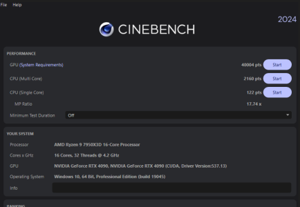

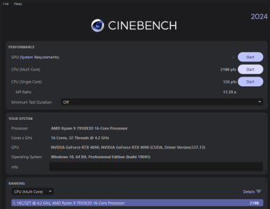

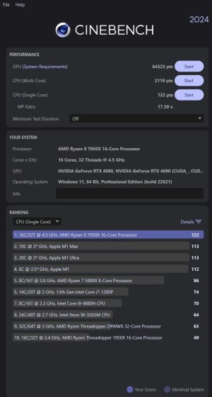

This one has my best GPU score
Best CPU score
Some folks are getting substantially higher CPU on the 7950x3d, not sure if eclk is being used, chiller, etc.
I dont know how you got even that 2188 score, i got only 2119 with my 7950x. And i actually meddled with it, increased the MT clocks to 5,25/5,175 on CCD0/1 - it was less by default. Perhaps CB24 actually takes advantage of v-cache, this time around?

randomhero
Apr 28, 2020
196
300
Yes it does. Go on chips and cheese site, they say that there is quite bit more trips to RAM, and that workloads can go over 8MB of cache per thread.

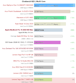

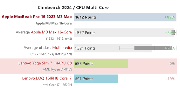

What is interesting is that M3 Max performs much better in CB 2024 than in CB R23.
59% higher score than 7840S in CB R23.
89% higher score than 7840S in CB 2024.
That's a big improvement. Why?
Now that I look at It, 13620H was on par with 7840S, now It scores 19% less in comparison.

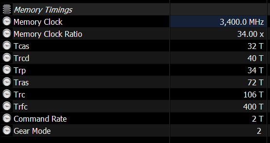

Timmah!
Jul 24, 2010
1,572
935
Could be the higher RAM bandwidth that helps the CB2024 renderer.
Oh, you see, that may be other reason why i scored less, i run only 6000MHz RAM, when other people may run 6400+ or whatever is even possible nowadays with those latest BIOSes.
View attachment 89040View attachment 89041
Part of it could be due to poor NEON implementation in Cinebench R23 (which was done with a tool to convert SSE/AVX to NEON it seems).

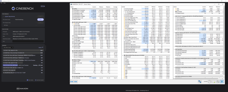

Rigg
May 6, 2020
718
1,822

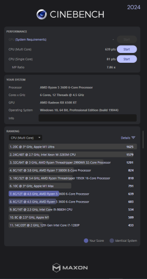

R5 3600 @4.5 Ghz
Termalright Assassin King 120SE w/ Noctua NF-F12
Reactions: lightmanek

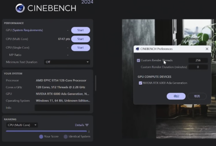

nicalandia
Jan 10, 2019
3,331
5,282
What I still am missing on Maxxon's web site is the info on the maximum number of logical CPUs which the CPU renderer benchmark is able to utilize. Previous versions of Cinebench are known to be unable to use all hardware threads of modestly modern dual-socket computers with higher core count CPUs. I also quickly looked around the Cinema 4D and Redshift sections on Maxxon's web site and haven't found the equivalent information there either.
Cinebench 2024 Can not use more than 256 Threads. It used half of the threads on a 2S Bergamo.
