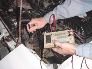

To do a voltage drop test, you create a load in the circuit that's being tested. Then you use a digital volt meter (DVM) to measure the voltage drop across the live connection while it is under the load. Voltage always follows the path of least resistance, so if the circuit or connection being tested has too much resistance some of the voltage will flow through the DVM and create a voltage reading.

A. Set your DVM to the 20 volt scale, then connect meter positive (+) lead to battery positive (+) post (not the clamp or cable), and the meter negative (-) lead to battery negative (-) post.
B. Disable the engine so it will not start when it is cranked. (Ground the ignition coil wire, or disable the ignition circuit or fuel pump relay.) Limit cranking time to 15 seconds or less.
C. While cranking the engine, record the volt reading on the DVM. D. Next, connect your meter positive (+) lead to the battery terminal stud on the starter, and the meter negative (-) lead to the starter housing.
E. While cranking the engine, record the volt reading.
F. Compare the two voltage readings. If both are the same, there are no excessive voltage drops on the positive feed side.
G. If available voltage at the starter is not within one (1) volt of battery voltage, there is excessive voltage drop in the circuit.
