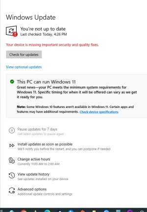

Cant update to Win 11
ondma
Mar 18, 2018
3,323
1,716
I am so frustrated with trying to update my computer to Win 11. I am currently running Win 10 and have downloaded the Win 11 update assistant. When I run the program everything goes properly and seems to be working until the installation starts. Then I get an error message that says "Windows 11 cannot be installed on a flash drive". I am not trying to install it onto a flash drive!! I am trying to update the current install of win 10 on the boot drive. I have checked the bios that the correct boot drive is selected. I get no option during the update to state what drive the update should be installed to. Obviously, it would seem that the update would automatically install onto the boot drive, but that does not seem to be the case.
Am I doing something wrong? I ran the PC check and it said my computer was compatible with Win 11. (cpu is 8700k, OS is Win 10 Pro). Any suggestions how to make this update possible?
I dont really want to do a clean install of Win 11.

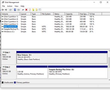

A little more information:
Here is a screenshot of my files on C: (taken from EaseUSA backup file selection). It says the disk is GPT, but then it says Windows is NTFS. So it looks like your screenshot in post 4. The disk is GPT, but the windows partition is NTFS. (What a clusterf...). If most win 10 computers are like this, there is no way the ordinary user is going to be able to figure out how to update to Win 11. Actually, even as a fairly knowledgeable user with the assistance from all of you on this forum, I'm still not sure I want to risk borking the entire computer.
@Indus: Here is an article from Windows Central detailing how to convert for MBR to GPT using the "mbr2gpt" command without cloning the OS drive and booting from an external disk. Do you think this would work? Still seems like a lot of places for things to go wrong. It says toward the end of the article that it will not work if there are more than 3 partitions, because it needs to create a new partition for the UEFI. This might be why it didnt work for you. https://www.windowscentral.com/how-convert-mbr-disk-gpt-move-bios-uefi-windows-10

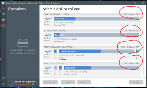

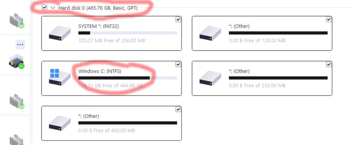

Well if your drive is already GPT it doesn't need to be converted to GPT again. So that raises more questions than it answers that why is Windows 11 not seeing your hard drive if everything is set correctly to UEFI/ GPT.
And for the unrelated bit, I only had 1 partition on that windows drive as you saw. The other 2 small ones were taking by the windows bootloader and system. I can't even assign a letter to them in windows.
I have an idea though.. reformat your USB flash drive.. put ventoy on there first and then instead of how you would convert a USB flash drive to bootable.. instead just copy over the whole windows 11 operating system. See if that fixes whatever is fubar.
After using Linux full time for a month.. I swear linux might seem complicated at first but it's mostly just the user not knowing how to do stuff.. once you follow google search advice, it's quite simpler than windows which leaves you at its mercy of does it like you or not that day.

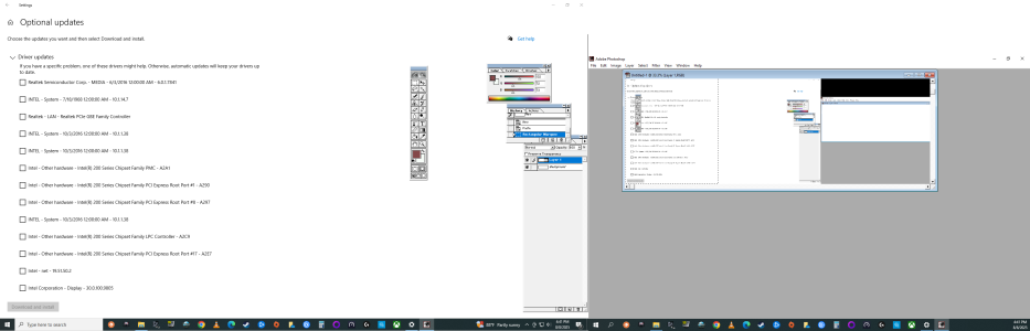

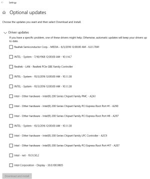

Here are the optional driver updates that are listed. Note that most of them are very old. That, and the fact that it says the drivers should be updated automatically, has made me reluctant to install any of them.1754690073176.jpeg
tcsenter
Sep 7, 2001
18,954
577
It is a prebuilt system, a Powerspec from Microcenter. As for the updates, something is borked there too. If I go to the Windows Update page, it says "Your device is missing important security and quality fixes." But then when I click the "check for updates" box I get no updates. If I click on the "view optional updates" I get some driver updates, but have not tried to install those. Funniest of all is the big green checked box that says "This PC can run windows 11". Well maybe it can, you just cant install it.
There was an issue on W10 awhile back where one of the updates wouldn't apply if the WinRE Recovery partition was not large enough. The default partition size created by Windows SETUP had been 530MB (same as you have). People were having to increase the size of that partition to > 600MB. e.g.
Check through Windows Updates history to see if KB5034441 was successful. Or any other failed (still outstanding) updates, really.
