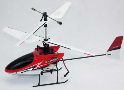

Here is me piloting a rc helicopter, is there a way to control it with my flight controller?

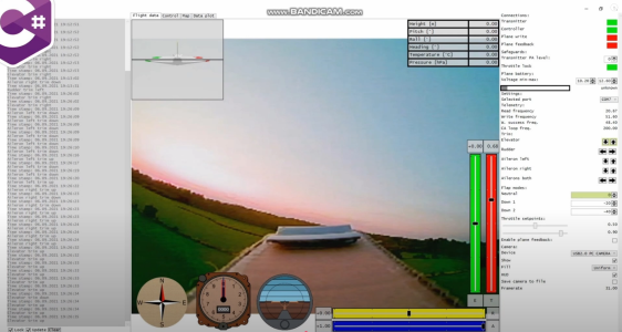

I found a couple of interesting sites:
I have a feeling getting your current copter working with this sort of software will be inordinately hard because (1) it's cheap, probably not using standard parts and (2) it's not a quadcopter, so it's unstable and much harder to fly.

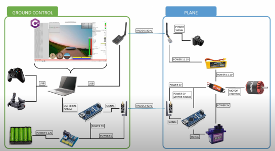

Yes, there are a variety of ways to do it! The control split is:
1. Visuals
2. Controls
For visuals (optional, but nice to tweak the control parameters in the field!), two good routes via cameras are:
1. Screens (ex. tablet or iPhone)
2. VR/AR headsets

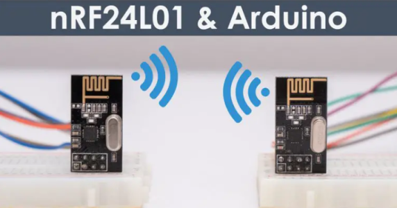

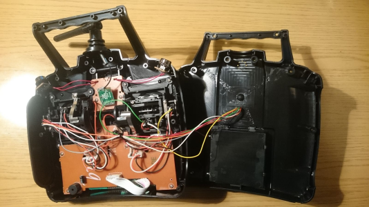

For controls, you need to replace or control the transmitter in order to control (or replace) the vehicle's receiver, which in turn controls the motor & the servos. There are a variety of ways to do this! You can get an Arduino Nano clone for under ten bucks on Amazon:

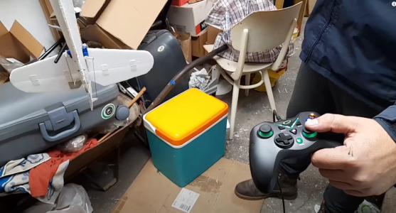

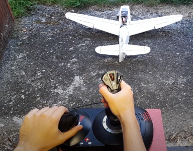

You can use a gamepad:
Or a HOTAS setup:
You can also do the reverse, i.e. use an R/C transmitter to control flight sim games on your computer!
Be sure to check out Dronecode!

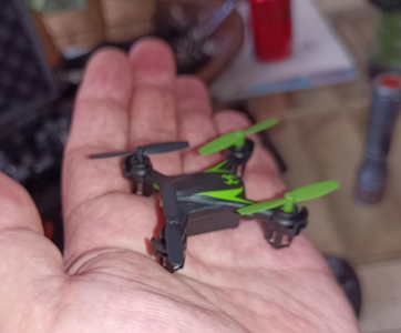

These days, you can buy a single-head mini chopper at CVS for $19.99 lol. The gyroscopes got better & now you can buy micro-drones for less than the price of a large pizza:

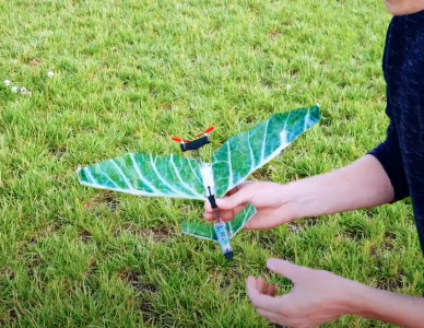

Now you can make lettuce fly lol:
Remote-control a leaf, haha!

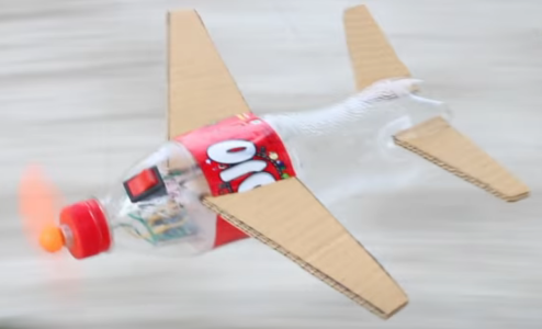

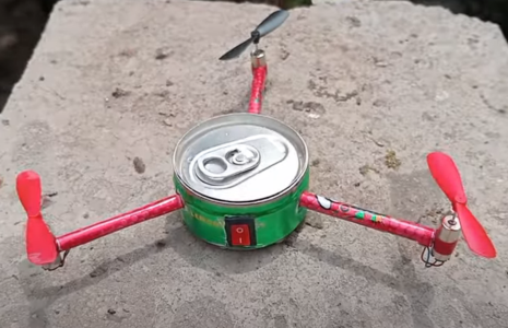

Thanks to cheap hardware & great software, you can now make R/C drones at home using cardboard!

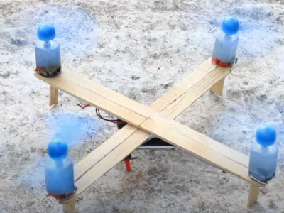

Or a soda bottle haha:
No budget? No problem!
Or even popsicle sticks!
