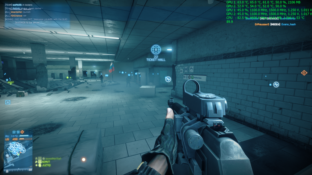

I was trying to get HWiNFO going so I could see my CPU usage in GTA 5 like this. I downloaded the program and got it running but not sure how to actually activate the OSD.
Install HWInfo and run it in "sensor" mode only on startup, then hit configure down the bottom (one of the icons), then click around and enable in OSD what you want. Make sure Afterburner and Rivatuner are running. You'll need to fiddle around with the columns.
