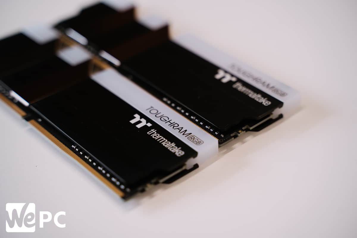

If you're running integrated graphics, it matters a lot. Anandtech did a review a while ago, so it only lists older games.
If you're running a dedicated gpu, it can decrease your fps anywhere from approximately 0-20% depending on the game. For the most part CPU and GPU play a much bigger role.
The wepc chart also shows how latency also matters, but to a lesser degree.
