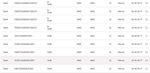

28,173
19,201
The QVL shows a few DIMMs with 1.2V so the mobo can handle that voltage. Anything higher may or may not work.

Can you link me?
From your link to the motherboard, go to Support -> CPU/Memory Support -> Memory

Yeah, I didn't realize those tables are the QVR. I thought it would be something more official.
