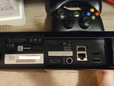

OK...Xbox 360E. No SPDIF connector, only what looks like a 3.5mm A/V jack. (plus HDMI, ethernet, and a pair of USB connections...)

The A/V jack uses a special cable to breakout a L/R audio and composite signal.
It came with the Xbox, so you should have it unless it was discarded.

Yep. Found that cable, connected it to the FiiO DAC/amp...and VOILA! I have sound.
