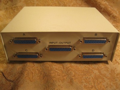

In the pro audio world, we have used the standard set by the Tascam DA-88, and used DB25 cables for carrying 8 channels of audio. DB25 manual switch boxes are dirt cheap, and the 25 shielded pins in the DB25 cable is nearly perfect for the 24 hot / cold / ground connections 8 channel audio carries.
The biggest cost is those snake breakouts (DB25 to XLR, TRS, or RCA). DB25 to RCA would be the least common, because they were the least professional, but sometimes you can find used snakes for a decent price. I would recommend the DB25 to TRS, as they're pretty common, and should be interchangeable among brands as long as they adhere to the DA-88 standard (leave pin 13 unused, wire channels 1-8 in triangle formation down the connector). Below is an example of what I'm talking about:
Get a bunch of cheap TRS 1/4" to RCA adapters, like from Monoprice:
Then find an old DB25 manual switcher. They'll be old looking, yellowed as a relic from the 90's, but you can find 4 port switchers for less than $20. See this for example:
Again, your snakes are going to cost you $50 per snake, but that in itself isn't so bad vs. the cost of buying 24 RCA cables to make the 3 connections (unless you're already drowning in them). And those industrial DB25 switchers are built like a tank and will pretty much last forever.
