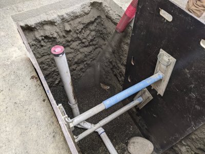

get a bark blowing truck to do it with pea gravel.
I had that done on a job inside a building.
They needed to turn a main line and bring it through a row of offices so they could demo the sewer main for an addition, and keep it all live.
Saw Cut room by room and retain the demizing walls, excavate with vac trucks to the tune of 20K, and then I and the bark truck placed 72 tons of pea gravel in 6 hours.
I had pre-positioned the 120 excavator there. He got a big (overweight) load on, I got one, and then I dipped it out of my truck and loaded his with the 120. He stayed and I ran for 12 tons at a time.
They could probably blow sand too.

my bark truck outfit would bid that at ~$500 or so. Done. Pea gravel falls at 95% and that is what I would recommend. Sand does not.

Back to the topic, not every bark truck can blow pea gravel. The ones that do, will haul all you need for that hole in one go. They would be in and out in an hour and that is where the ~$500 bid number comes from.
