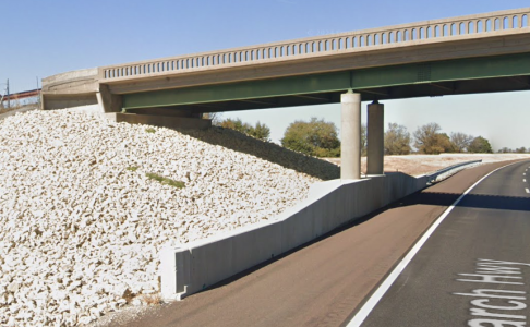

That specific bridge was in Kansas and its embankment extended quite a bit past its beam bearings, giving a nice protected area to take cover and the tornado didn't directly hit the bridge. Even Kansas has stopped using that style much, and there is much less protection than there used to be. Kansas also generally uses rock embankments, so you can enjoy being beat to death with them.
Modern KS design:

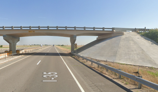

Oklahoma has a ton of concrete "haunch" bridges that have no beams to take cover in between and people get sucked right out and the embankments will be covered in debris, sometimes with people shaped holes. Most newer OK bridges are more similar to the newer KS ones with beams on bearings, but not that much depth to hide in. Unfortantly, people who've seen that video stop at the bridges and block the road for everyone else, so your options are ditch, car, or bridge (and the is the order you should generally pick).
Modern KS design:

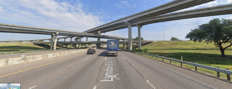

EDIT: now if you wanna talk about real fun during inclement weather, driving on those fucking mixmasters in TX stuffed next to some semis 50' in the air as a 17yo still learning to drive.
