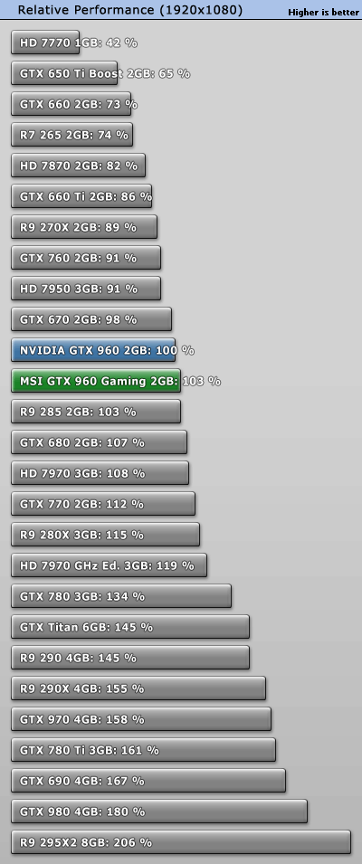

I had posted a comparison between overclocked Q9550,i7 860 and core i5 2500k paired with my GTX 970 a while back.
The Q9550 performed quite well, but not stellar, which was to be expected.
In these benchmarks, where you see that the Q9550 is the clear limit, your stock Q9400 would give around 2/3 of the performance.
Still, if you are planning to go 4K, you need the best card(s) money can buy. Even your Q9400 will do fine for 4K, because everything will run at 30-40fps anyway.

Do you play games? If you do, don't expect a gtx 960 to run well at 4k resolution. No freaking way. You're going to need the top of the line GPU to drive 4k gaming. I'm talking about Titan X, GTX 980TI & FIJI level GPUs.
If that's the Corsair CX 430watt, you drive a 290x with it. I've done it for over 6 months. It works fine. No shut down or crashes. I don't know about other PSU. I can't vouche for that.
If you want bang for the buck, grab an AIB R9 290. You can get those for around $250 and it would offer nearly 50 PERCENT more performance.
Or, you can wait for the lower stacks from AMD that will be coming soon. I am confident the R9 380 4GB will slaughter GTX 960 2GB.
