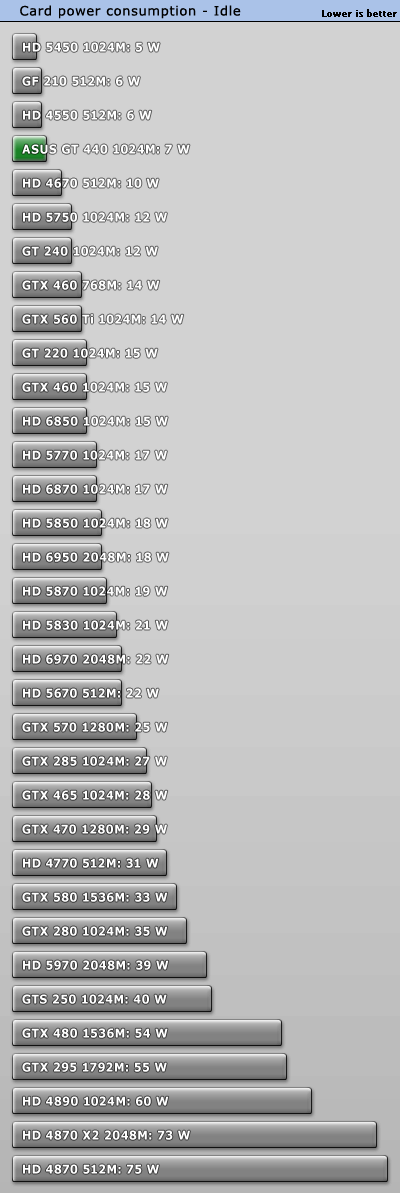

While thats a tempting price for a 4870, its time to let them go. Where they failed is a total lack of power saving features, for idle , 2d use your going to use a ton of power, whenever the computer is on.
75 watts VS 20 for any 40nm card.
http://www.techpowerup.com/reviews/ASUS/GeForce_GT_440/24.html
