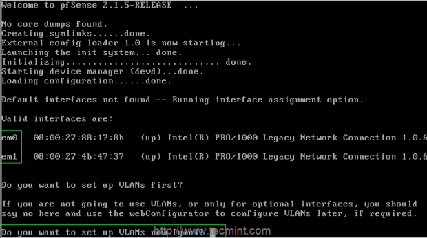

"em" means it's Intel NIC, "le" means it's AMD NIC, etc. pfsense use 2 to 4 letters to identify different NIC vendors.
what do you see on the middle of screen like this?
if it's detected as "ab0" and "cd1", then you have to use "ab0" and "cd1" to assign LAN & WAN, not em0 & em1.
if it's detected as "ab0" and "ab1", then you have to use "ab0" and "ab1" to assign LAN & WAN, not em0 & em1.
Nothing like that, it immediately wants me to assign names, it doesn't just give them. I know it is a valid card because pfSense would not let me proceed unless there were two NICs present.
