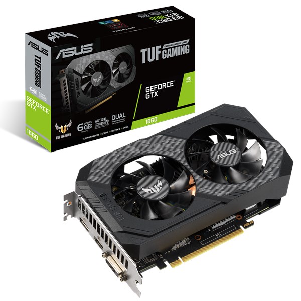

Hi,
I'm in the process of choosing a replacement for my computer, as I currently have an i5 2500K with 8Gb ripjaws memory on an Asus P8P67 EVO motherboard.
My graphic card just died a couple of months ago, so I replaced with a very cheap and basic geforce 210, just for the sake of being able to work, but of course no gaming since then.
So I now have a new Logitech G29, I want to go back to some gaming, which will include driving games (F1 2019, Assetto Corsa Competizione, Project Cars 2) and also some FPS in the likes of Call Of Duty. And I'm not a resolution perfectionist, so I'm not targeting a 4K with 100fps, as I have a 22" monitor with a 1680x1050@60Hz and have no plans to replace it (if it doesn't break, that is).
So I went to a shop, looking to buy a graphics card, an ssd and additional 8gb RAM to bump up the machine to a gaming status, but my motherboard (PCIe 2.0 x16) will just limit the power I could extract from a modern graphics card, and so they advised me to think about an upgrade.
I normally prefer to just use the hardware until I cannot extract enough power from it and so, against my non-consumerist behavior, I just made a list of components for a nice-to-have machine:
  • Intel Core i5-9600K Hexa-Core 3.7GHz w/ Turbo 4.6GHz 9MB Skt1151
  • Motherboard ATX Asus Prime Z390-P (P/N: 90MB0XX0-M0EAY0)
  • Memory RAM G.SKILL Ripjaws V 16GB (2x8GB) DDR4-3000MHz CL15 (P/N: F4-3000C15D-16GVRB)
  • Cooler CPU Noctua NH-D15
  • SSD M.2 2280 Samsung 970 Pro 512GB MLC V-NAND NVMe (P/N: MZ-V7P512BW)
  • Graphic Card Asus GeForce GTX 1660 TUF Gaming 6GB
So then I need your opinions regarding all this story, should or must I really go into a new build to regain a gaming machine for what I'm targeting for?
About the Graphics Card, it's very confusing at the moment ... we have TUF, 6G, with or without overclock (OC), TI or not TI ... they all look the same if not for some 3-4 fps difference? Or is there anything else I should account for and opt for a OC+TI version (that costs around 90€ more)? Spec numbers are higher with the OC+TI, but I will not be running benchmarks, I'll be running real games.
The processor is a 6-core with non-hyper-thread, should I opt for another one for a bit more money?
I really need your opinions as to get the most best spot on price performance.
Thank in advance.
