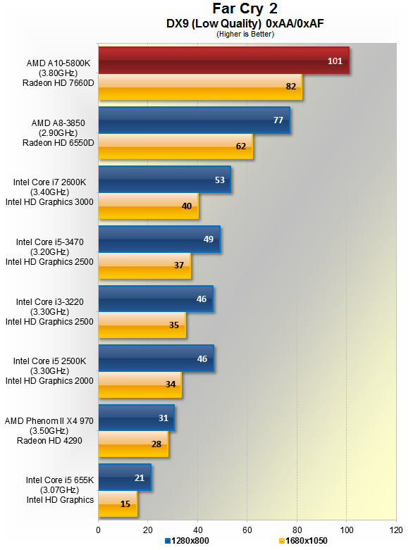

Did a bit more reading. There don't seem to be many reviews of the lower end APUs so we need to do some extrapolating.
http://www.techspot.com/review/580-amd-a10-5800k/page7.html
The A6 has half of the graphics cores of the 5800K, and the A4, 1/3. They're clocked slightly lower as well, but for the sake of easy comparison we'll ignore that.
In FarCry2, the A10 5800K pulls 101fps. We can extrapolate that an A6 would pull around 51fps and an A3, about 34fps. The HD2k and HD2500 get around 46fps.

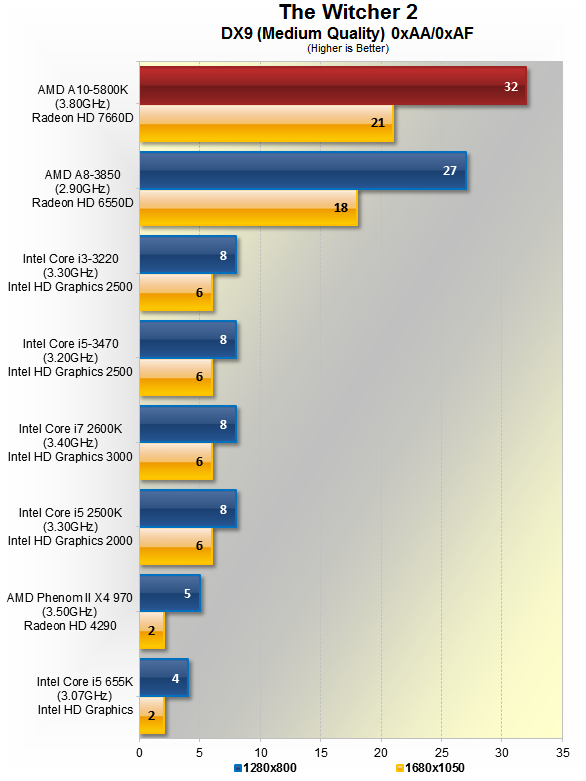

In The Witcher the A10 gets 32fps, putting the A6 at around 16fps and the A4 at around 11. Intel graphics get around 8fps.
