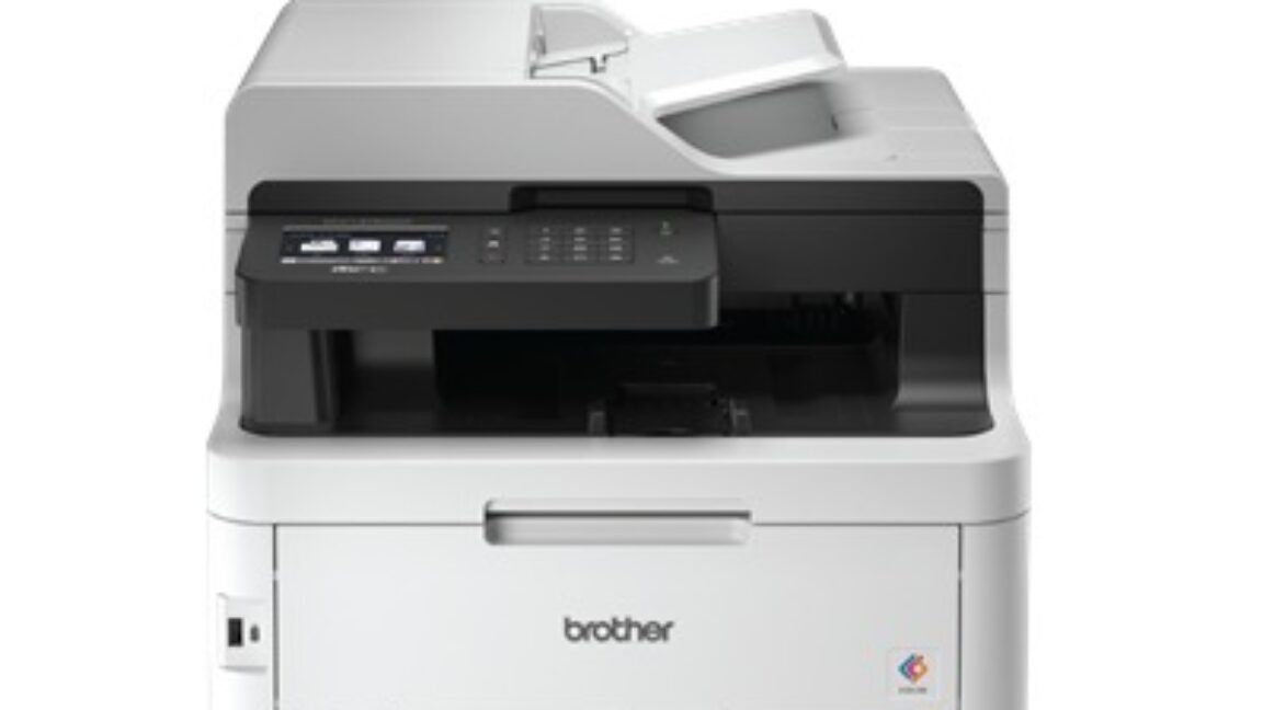

Question Brother turns to the dark side. No longer allowing 3rd party cartridges
