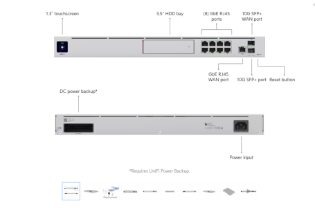

Wondering if anyone has tried this.
I had issues with ubiquity's transceivers. Meaning they would not work in 10G.
I wound up buying a full duplex auto negotiating transceiver from amazon. not I can get over 1G download speeds.
My PC has a 5GB ethernet port, so I got to thinking, and looking at 2.5 switches. (my modem only has 2.5G port or 1G ports on it)
So port 11 on the DMP looks to be an output port according to this. Which is the port under the 10G SPF port.
So main question is even without buying a 2.5G switch, would that #11 SPF port, OUTPUT with a auto negotiating SPF transceiver to the PC?
@ch33zw1z and or @aigomorla since I am almost certain you both have experience with the DMP or SE.
I am going to try it. Will lyk.

Port 11 with negotiate speeds to the other end, sure. Will it negotiate to speeds other than 1 or 10 gig, unlikely
What are you trying to setup a 10gig link between that didn’t work?
I was able to get a 2.5G link from modem to DMP with a negotiable SPF. Ubiquity's SPF to rj45 are 1G or 10G only.
If the incoming SPF I ordered which is same as one I'm using to get over 1G now will link to my PC at 2.5 or 5G then I will look at a higher rated switch.
Currently limited by my modem provisioning. Which is 1.2G and 60 upload. But our current system as is (HFC) has capacity for 2G and 175M upload.
I just kinda caught last night that port 11 may be an output SPF connection that is possibly for greater than 1G switching.
If the DMP CPU can handle the overhead of connecting it to a 2.5 or 10g switch. (If that makes sense)
I should be able to confirm tomorrow night if shipping isn't delayed.
EDIT: Forgot to hit enter on this post. So I will add to it below.
Yes it does work. Current modem provisioning is holding back but our rural system can get to 2.1G and 175M up in current state.
11 port with transceiver auto negotiated to 5G link speed of motherboard.
Port 10 SPF connects to modem which only has 2.5G port on it.
