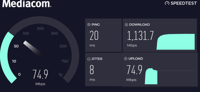

Yes it does work. Current modem provisioning is holding back but our rural system can get to 2.1G and 175M up in current state.
11 port with transceiver auto negotiated to 5G link speed of motherboard.
Port 10 SPF connects to modem which only has 2.5G port on it.

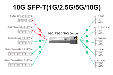

Its the UI SPF to rj45 transceivers. Not a cable. Speaking of those I have a faulty termination in one, it's all got stuff under and against it to it's green light on the switch. I am using premade CAT6 for modem to DMP and DMP to my PC which was on the prior, it is also a CAT6 premade just shorter than 6 ft.
UI SPF to RJ45 would not do this. The right side of diagram. They are only 10 or 1.
EDIT: I didn't know that when I bought them. Thought everything auto negotiated then.

The SFP+ to Rj45 claims 10 / 5 / 2.5 / 1
SFP to RJ45 is just 1Gb

No.. the SFP+ does not auto negotiate like a 10G RJ45 would.
Its either full boat 10G or 1G. thats it.... while as the a real 10g port would do 10/100/1G/5g/10g.
If you want 2.5gbe adoption which i did reciently.. you need to do this...
This guy needs to sit on top of your unifi system for the cheapest solution.
Then connect that guy to the unifi SFP+ port. That way the 2.5G switch talks to the unifi switch at 10G.
And then the 2.5G ports handle the 2.5G.

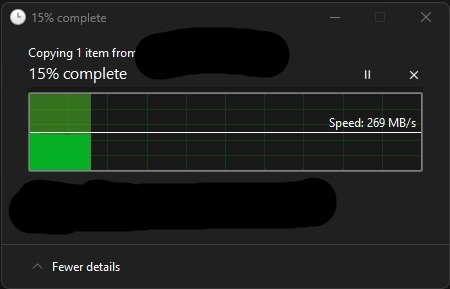

If your also wondering how fast 2.5g transfers are...
Its not bad... but im still keeping my main NAS's and servers tied on the 10G.
