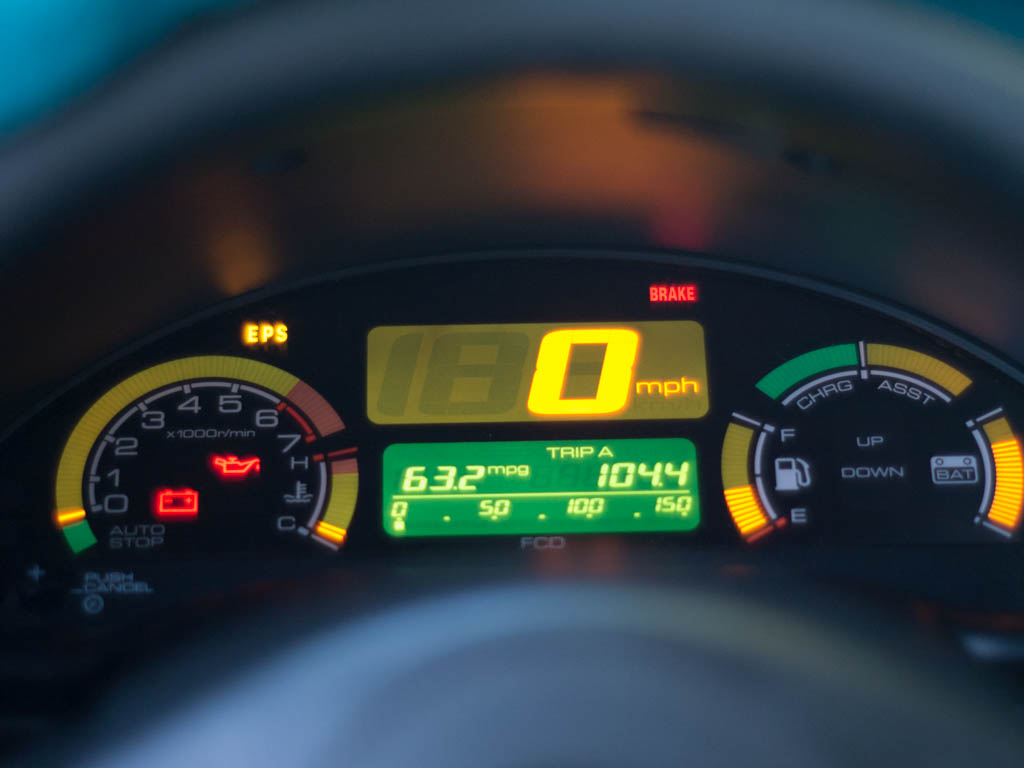

Drove it 100 miles back home and the computer says I averaged ~63 MPG

Fuel economy for the trip back home. Net 500 ft elevation gain with garbage off-brand china tires.
Not too bad.
