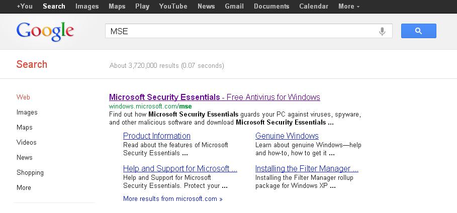

So if I disable MSE I can boot in -5.74 seconds?
No, but that might apply to Norton or McAfee. 😀
My 19 second to desktop from pressing the power button is with MSE running. MSE seems to be pretty good at not eating up resources.
