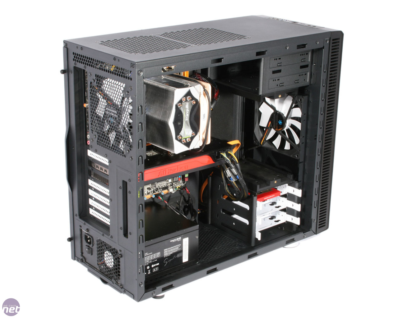

For example, this is the Fractal R4 case that looks like your typical gaming case with 'good' airflow. And yet it isn't.
CPU & GPU cooling performance cannot be described by anything other than terrible. This 'modern' case which represents the typical Antec 183 style box case design, and other similar cases are not adequate to cool a modern gaming system @ quiet noise levels without raising CPU and GPU temperatures by 10-20*C. The result of using such a case combined with a blower GPU reference design is what's forcing the GPU to ramp up fan speeds to even higher speeds to maintain reasonable GPU temperatures further exacerbating the noise levels in such a system.
If a gamer has a case with good airflow, he doesn't need to enable temperature controlled fan settings in the BIOS. You can run all your fans @ low RPMs, get quiet after-market fans and still sustain amazing cooling performance and noise levels. And such a case would have no trouble at all dealing with an after-market dump of 300-500W of heat dump.
If you guys bought a modern case with good airflow, put in a 250W GPU in it, and actually tested this in the real world, you wouldn't be defending the blower GPU designs. In fact, you'd probably never buy a blower fan GPU design ever again unless limited by space constraints in Tri-SLI or similar.
When I ditched my Thermaltake Soprano case for the case in my sig, my Core i7 860 @ 3.9ghz temperatures dropped 9-10*C at full load and I had one of the best air coolers at the time: Prolimatech Megahalems + Scythe S-Flex-E fan. Keep in mind the performance of the Megahalems is among the best air coolers on the market. This type of temperature drop by just swapping the case is nothing short of incredible. The result were lower temperatures and noise levels across the motherboard, CPU, hard drives and GPU.
It's pretty unfortunate to see that even in 2012 PC gamers continue to disregard how important case cooling is and instead of solving their case airflow problem, they resort to buying reference blower GPU designs when the problem is right in front of them: their case airflow!
