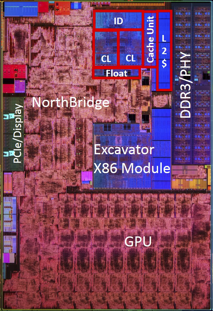

Here is a picture of the Carrizo die (which we have been led to believe is the same as Bristol Ridge, but with DDR3 enabled rather than DDR4)
If true, maybe they just extended the GPU portion a bit further and kept everything else the same?
With a DDR4 2400 IMC it would be starved for bandwidth (even with GCN 1.2 DCC increasing bandwidth efficiency ~35% over what Kaveri had).
But then again OEM Kaveris were bandwidth starved at dual channel DDR3 1600 and AMD didn't seem to care.
