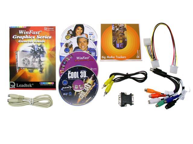

HERE
it looks like there is an S-video to component video adpater in that picture.
Would it improve video quality if i got it? On a 36" sony tririntron HD TV?
also, where would i buy one?
thx
~RaNDoM
Originally posted by: RaNDoMMAI
HERE
thx
~RaNDoM
Thats the accessories bundle for the Leadtek FX5950 ULTRA WinFast A380 TDH MyVIVO card, since the picture is from Newegg, I'd say you can get it at Newegg and its all free (when you buy the card) for $387.00 it should improve something 🙂
That's not an S-Video to component cable. It's some proprietary plug that can output component, S-Video, and composite from the same plug. Converting S-Video to component wouldn't do you any good just like recording a VHS tape onto DVD isn't going to make it look any better. The easiest way to get good quality TV-Out is to buy a transcoder that will convert VGA or DVI to component or S-Video. They start around $125.
