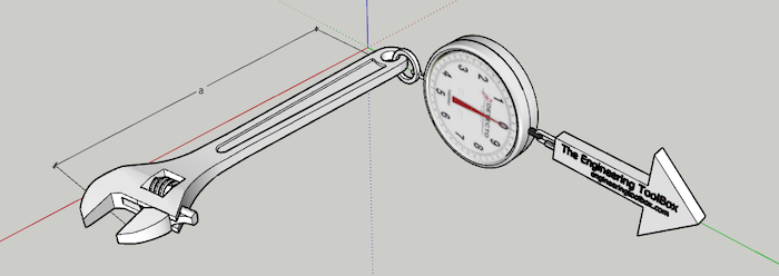

Cant a luggage scale placed in a known measurable spot along a long wrench perform very accurately? Won't break and can also be used on your vacations to avoid overweight charges.
http://www.engineeringtoolbox.com/torque-wrench-luggage-scale-d_1909.html

I have actually used similar concept to verify the accuracy of my torque wrenches. I actually used the bathroom scale and jury rigged few sockets and extensions but the basic idea is the same.
