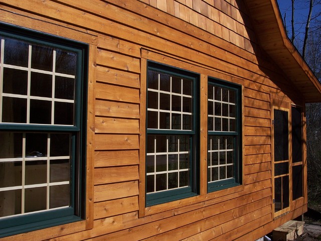

I like the traditional hardwood boards..I just love it! More maintenance for sure, but a great and timeless looking classic. It's also easy to work with and repair:
