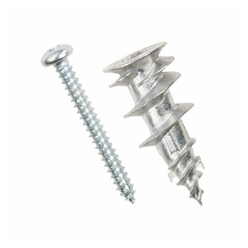

I'll use metal or plastic screw in anchors:
E-Z Ancor 4-Pack 1-1/4-in L x 3/8-in dia Standard Drywall Anchor ...
