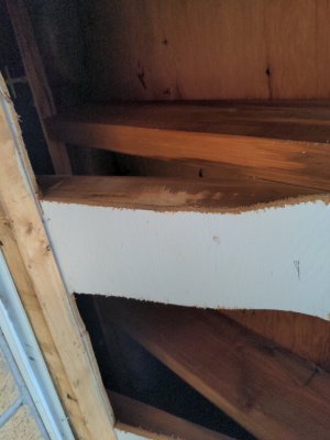

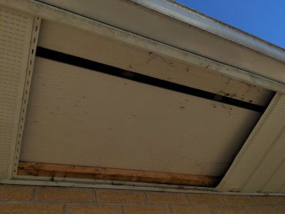

Finally continued on the chimney which I've been procrastinating since messing with the soffit/overhang is tedious but got it at least partially opened up. Of course with my luck there's a rafter right in the way, but I analyzed the structure and it's not structural to the roof itself. The diagonal section for the roof sits on the wall, which is further inside and the horizontal piece does not actually extend all the way inside, it's just to complete the overhang. So cutting it out is fine. Saves me some work. I didn't end up taking pics when I finished opening up the white plywood but this is how it looks under the soffit part and after initial cutting to get a peak inside.

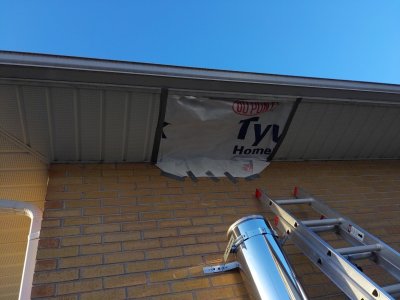

Was getting late and the days are getting shorter now so didn't want to continue further, but I'm ready to punch the hole through the roof at this point. Covered it up for now so critters don't go in there.
With my rate of procrastinating, it's probably going to stay like that for another 3 months. :p But seriously, probably going to continue on Saturday. I really want to get this done, and move on to a few other projects like my firewood storage setup. I don't want to go another winter without the wood stove.
After this is done, I just need to finalize the stove pipe inside, which is easy, and then I'm ready for WETT certification and to notify my insurance. Hopefully it passes.

Like to go around the joist? Ideally want to minimize bends especially since I already have a 180 degrees worth of turns with the stove pipe and the T connector. Normally you're suppose to go straight up through roof if at all possible but in my case it was really not practical to do since it's in the basement. My attic is also not easy to access so I avoid going in there at all costs.
Going around the overhang was also not an option at all, the pipe would need to be way too far from the house and it would end up looking really weird. The way I'm doing it is pretty much the easiest while minimizing bends. This type of pipe is not easily customizable, you buy it in sections like 3' or so, it's not made to cut like ductwork. There are some slight bend connectors you can buy but it's really not designed to wrap around stuff.
