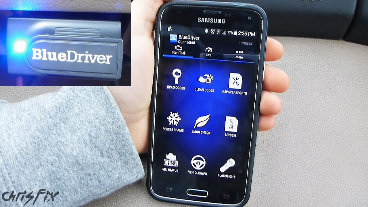

I did my first engine fix yesterday.
Got a CEL on my Malibu. I have a BlueDriver Bluetooth OBDII scanner and is showed a problem with the exhaust camshaft solenoid.
Turns out to fix it all you do is unhook the battery, three hoses, the oil cap and remove the plastic engine cover. The solenoid is sitting right on top of the engine.
(Two black guys with the cables running to them, left is intake, right is exhaust)
For $35 I got a new exhaust and intake solenoid from Amazon. (Might as well change the intake too since they are both almost 10 years old and right together)
Took about an hour. Probably saved me $500 if I had the dealer do it.
