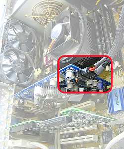

First of all, is this cable plugged into the motherboard? And is this cable plugged into the video card (if your model takes one, that is)?
