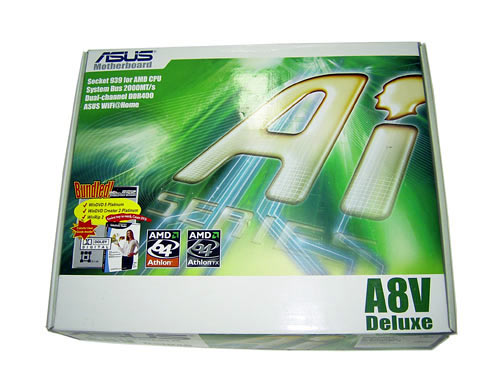

I think all of the 1.0 versions has their wireless adapter included.

Also the 2.0 came in a White BOX, and the early models shipped in a Mostly Green Box.

Thanks guys, as you said, found it between the PCI slots. Is Rev 2, (in mostly white box). I'm happy now....
