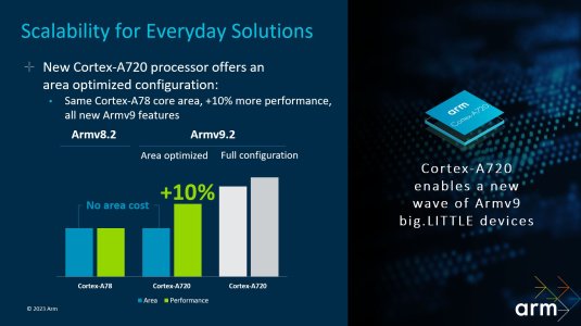

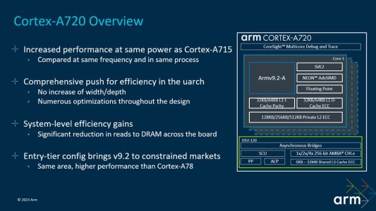

according to Arm A720 is 10% faster than A78 at same area usage.
you can even check real life scores, botth dimensity 7300 and snapdragon 7s gen 3 has same frequency, one use A78 and other A720, difference in geekbecnh single core is around 10%.
OK now you just jumped to a totally different metric.
I was initially talking about perf/watt first, and then refuting your point about A78 -> C1 Pro being marginal in the assumption that you were talking IPC.
Also that A720 = 10% better IPC at ISO area claim was for an area optimised variant of A720, and not the µArchs base IPC....
What about geekbench? Same node same frequency difference was 11% there.
