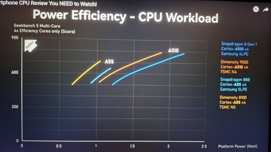

Seems like Cortex A510 and Samsung 4nm is not a good mix...
RIP Tensor G3.
qmech
Jan 29, 2022
82
179
66
RIP Tensor G3.
Those are, unfortunately, not comparable A510 cores. The Snapdragon 8g1 features a merged core design and less cache at every level above L1 (and possibly even at L1, since ARM allows 64 kB to 128 kB total L1). The Dimensity also features more advanced memory, leading to (according to MediaTek) 17% faster transfer speeds and 15% lower latency - in addition to (according to Samsung) 20% lower power consumption. The merged core design also shares the NEON SIMD engine between pairs of cores, the bandwidth of which can additionally be halved.
So, basically, the two A510 "systems" are *completely* different.
Reactions: Tlh97 and Lodix
FlameTail
Dec 15, 2021
4,384
2,762
By 'memory', you mean RAM ?
So yes the Mediatek *supports* LPDDR5X but the phone in question should have it to take advantage of the gains you mentioned.
But shouldn't the merged core design theoretically be more efficient?
qmech
Jan 29, 2022
82
179
66
Yes, by memory I mean RAM. Without knowing the exact model used, one can obviously not be sure what kind of memory is in either phone nor the bandwidth.
As for the merged core design being more "efficient"... That depends very much on which definition of efficient you are using. It is certainly more efficient in terms of die space. It also has the potential to be more energy efficient at minimal performance. Running GB5 on the cores is not in this range of "minimal performance".
However, if you look at the power required to reach a certain level of performance, the merged design would likely need to run at a higher frequency. If the benchmark makes extensive use of NEON SIMD instructions, that frequency differential could be quite substantial. The merged design also has half the L2 cache bandwidth and half the L2 cache per core (256 kB per core *pair* on the 8g1, as opposed to 256 kB per core on the Dimensity). See the annotated die shot in here. Less L2 cache is, generally, going to hurt performance / watt at higher CPU utilization rates. I haven't seen A510 latency tests, but I also wouldn't be surprised if the merged core has a higher latency to L2.
Bottom line is that the merged A510 does have the potential to be more efficient at very low power on cache-light load that doesn't use too much SIMD. The GB5 benchmark is unlikely to illustrate that. (And, frankly, that's not what the cores were meant for.)
