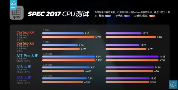

Hoho, now that I have the numbers (PPC), I think I can interpret what he said:
  • Qualcomm's custom core is basically the same as Apple A14 in terms of IPC, which is slightly better than Cortex-X4: Yes, my number aligns with what he said, see the table above with A14's IPC
Yeah A14 IPC is right. A17 and M3 have about 12-14% more IPC even at their higher frequencies.
  • Cortex-X5's IPC will surpass Apple, according to the leaked score of 1930 GB5 and 2700 GB6 @ 3.35GHz: Yes, D9400's IPC/PPC is 5% higher than A17 Pro.
If that’s true then I wonder what power looks like.
Usually wider, smarter cores (not always but assuming they were done correctly) are more efficient for the same performance but it’s always possible Apple has them matched on power — the X5 in the D9400 rumor was not good on that note — albeit for more performance (2900 GB6 can be found). Would be a rare case but it absolutely is possible especially given Apple’s memory hierarchy and L2/SLC sizes.
  • If X5 manages power well, Nuvia can only explode to surpass: With lowest clock speed, I am not too worried about thermal power. And Phoenix core is really behind Cortex-X5 in ST, even you OC, it is still the same IPC, Qualcomm has to hope for Pegasus core to increase IPC...
Yeah I mean if Arm pulls something off here where they match Apple IPC AND get their power under control, even if it’s a huge area hit which is worthwhile, then it would be almost comical timing RE: Phoenix core
What's your IPC numbers come from? SPECint?
D9300's Cortex-X4 comes with high power because they are made by N4X process based on Wiki. Now we know why Mediatek insists of 4P+4E with HPC process. Mediatek is treating D9300 as PC SoC and it is all because of WoA....
That's why I said D9400 with N3E would be more power efficient than D9300...
N4X? Plausible. That explains Mediatek's claim that D9300 is fabbed on '3rd generation 4nm process'.
Still, that's not only reason for Cortex X4's high power consumption.
X4 in 8G3, which is fabbed on N4P, also has high power consumption.
It is not N4x. N4X is extremely leaky. It’s N4P.
And the X4 power isn’t terrible relative to like AMD and Intel PC stuff, still a good mobile core it’s just not great since even the A16 beats it nontrivially on spec with 10-15% less power.
