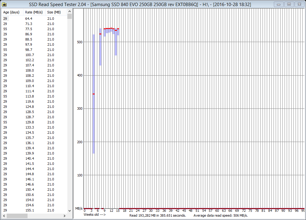

In comparison, here are some results from both 840 EVO (old firmware), and two 850 EVOs:
First the 840 EVO:
Now the 840 EVO has been unpowered between tests and the older folders were added when the drive was hot/pretty warm, the next to last when it was lukewarm and the last folder was added when it was like a few degrees celsius.
As you can see read speeds still haven't dropped that much, that is except for the last folder but considering the conditions it's not that bad.

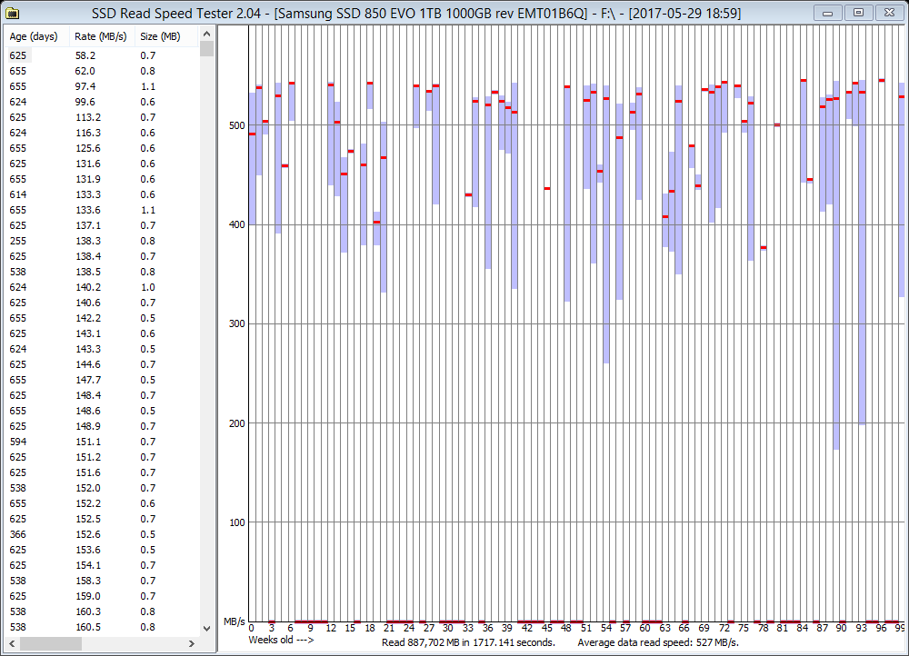

Here we have an 850 EVO:
It's been tested in the same way as the 840 EVO but it has been left unpowered longer between tests than the 840 EVO.
As you can see even the four month old folder which was added when the drive was only a few degrees above freezing still has an average read speed that is more than twice as fast as the 850 EVO in the link.
And here is another 850 EVO:
This 850 EVO has not been tested in the same way as the others (it's my game drive).
Also worth noting that it's the same capacity and uses the same firmware as the 850 EVO in the link.
It doesn't really have those issues with low read speeds either.
So I don't know what's going on with that 850 EVO but it seems like there might be something very wrong with it.
My speculation is that to overcome TLC issues it required a big jump in ECC with BCH to LDPC. The general thought that manufacturing alone (with the shift to 3D NAND and etc.) may not be accurate. Similarly (I actually believe commentary from yourself) that suggested newer (than the 840 EVO line) 2D TLC drives had better than expected retention when paired with newer controllers (as they may likely have better ECC).
More like that they were able to maintain high read speeds better than expected than that they had better data retention.
Not saying that they have poor data retention despite having fairly high read speeds, just pointing out the difference.
But, yes, there are some drives with 2D TLC NAND that have had pretty good read speeds and slowed down less than some drives using 3D TLC NAND or 2D MLC NAND.
These drives however; all use BCH ECC while those with 2D TLC NAND that have had issues with dropping read speeds use LDPC ECC.
That may change after a bit more wear because right now those drives using LDPC ECC aren't as worn as those with BCH ECC so if they're less sensitive to wear then the gap may decrease.
Tested a drive not that long ago in fact using 2D TLC NAND and BCH ECC after a lot of wear and after it was unpowered for a year and it had better read speeds than a drive using 3D TLC NAND.
Which brings up further questions with respect to QLC. We have neither the jump in manufacturing (in fact manufacturers may be going down in feature size again post 128L) nor do we have the next step beyond LDPC.
Toshiba used to advertise QSBC as being significantly more effective than (one version of) LDPC ECC.
Still taking those claims with a grain of salt however.
