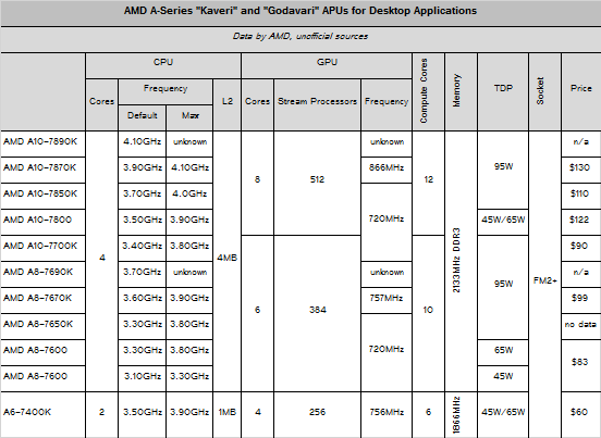

New Kaveri/Godavari SKUs :
The 7890k is unexpected. Some buyers of the 7870k may be annoyed by that announcement, or maybe they'll just shrug their shoulders when they realize that both the 7890k and 7870k probably top out at 4.7 GHz anyway.
Abwx
Apr 2, 2011
11,515
4,301
That s indeed the same chips, and according to Kitguru Godavari power plan was enhanced in respect of usual Kaveris, that s supposedly the reason of their higher frequency ceilling although usual chips did obviously benefit from a matured process.
AMD’s latest accelerated processing units that belong to the “Kaveri Refresh” family feature a reworked power supply circuitry, which gives cleaner and higher volume power delivery to the die. This lets AMD to increase “official” frequencies of its highly-integrated desktop chips and which also provides overclockers a significantly better headroom for further tweaking. In addition, AMD is able to bolster clock-rates of its chips thanks to the fact that GlobalFoundries’ 28nm super high performance (SHP) process technology has got significantly better than it was early in its lifecycle.
http://www.kitguru.net/components/c...ster-a8-and-a10-accelerated-processing-units/
