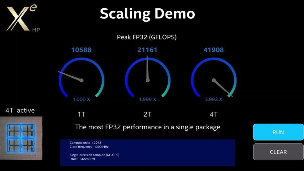

for their 128 cores GPU i'm expecting something like a 4 tiles gpu with 32 cores per tile (512 Execution units)... just like intel Xe HPC with 2 and 4 tiles... not good for gaming but great for everything else, just what imac pros are made for. and then 1 tile for the imac, just like the intel Xe HPG.
