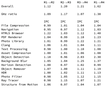

Still, it is not untrue that Apple's P-core IPC gains have levelled off in the last few years, with huge power consumption increments due to pushing frequency.
It is true, to a certain degree. We do observe some power inflation since A12. For example, M4 cores seems to use ~7 watts compared to M1's 5 watts. Some have interepret this as stagnation, others see it as a transition from a smartfone-focused core to a more desktop-focused core.
Also, it's important to keep in mid that while the power consumtpion is indeed increasing, we are still looking at sub 10 watt per-core power draw (at least according to instruments). I'd say that Apple still has a lot of headroom here.

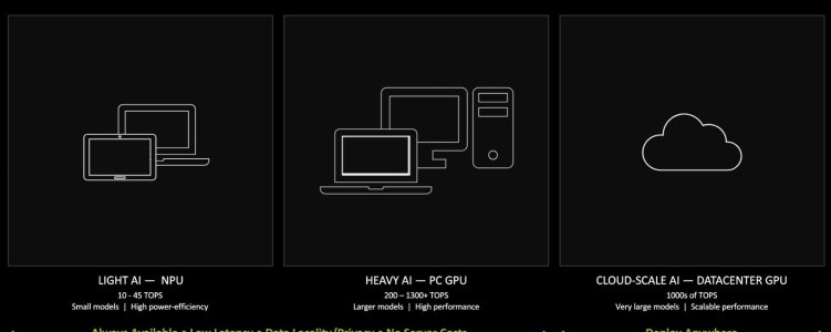

I think this slide from Nvidia sums up Apple's dilemma
Nvidia designates AI in the edge, as 'Light AI' and 'Heavy AI'. Light AI is powered by NPUs (~45 TOPS) and Heavy AI is powered by dGPUs (upto 1300 TOPS). Now, this classification perfectly suits them, because they are a GPU company, They do not make CPUs or NPUs for PCs (atleast for now).
Circling back to Apple, Apple does not make dGPUs. Their Apple Silicon combines the CPU, GPU and NPU into one chip. This then raises the question of how Apple is going to approach AI hardware
Right now, in the M3 series used in Macs, the 17 TOPS NPU is evidently not powerful enough for heavy on-device AI. People running Heavy AI models such as Llama3 on Macbooks have found that it's the GPU that's getting utilised when running such models. This makes sense, because the GPU is more powerful than the NPU.
But in the M4 unveiled recently, the SME got SME, which in it's own gas 20 TOPS of INT8. The NPU also got a leg up, to 38 TOPS of INT8.
This, then raises the question of what is Apple's future AI hardware strategy. Will they scale up the NPU to larger sizes/TOPS in the Pro/Max/Ultra SoCs? Or will the GPU remain as the first class citizen for running on-device Heavy AI? Where does the CPU with SME belong in this tapestry?
Reactions: Mopetar
Nvidia is a company with a ‘hammer’. Nvidia’s mobile offerings had great promise but too much of the power budget was allocated to the GPU. Great for handheld games but not mobile phones. Power matters and you have to use what the technology of the day gives you. ‘Heavy AI’ is apparently going to be fairly limited in scope if it needs 200-1300 TOPS. Limited in scope means millions and not billions. Apple’s market is 200 million plus smartphones (<10 wattts) and 10’s of millions mobile (10 - 50 watts) and maybe a million devices greater than 50 watts.
Blackwell on the N4 node needs about 50 watts for the minimum 200 TOPS of ‘heavy AI’. Is that feasible for Apple given their market? How much engineering effort do you expend to be at the bottom of the ‘heavy AI’ market as defined by Nvidia.
My guess is that Apple is focused on what they can do for 200 million or the 10s of million iPad/laptop users and leave the 200+ watt desktop AI to others.
Models that are designed for dGPU run on M-series GPU. Big surprise.
That doesn't mean a model designed for ANE can't run on ANE...
I think Apple's OpenELM also runs on ANE but I can't get definitive confirmation.
The other Apple stuff created with CoreNet, like the MobileOne vision net definitely runs on ANE, and if you read between the lines the papers describing the model are mostly describing changes made to better fit it to ANE.
They'll likely continue to increase the NPU at a higher rate than the GPU. But it will never be able to inference the best models locally. So they'll put something like "Siri Pro" on the server while normal Siri will be local.
