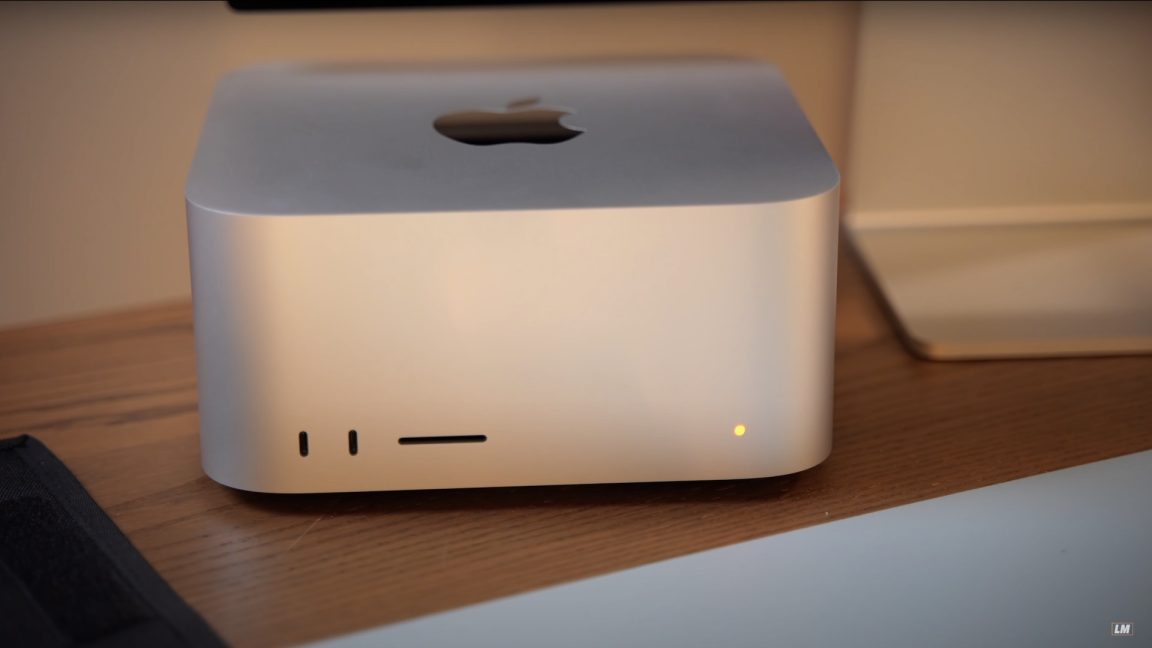

My only storage concern is with soldered in desktop storage, like on the Mini being a significant detriment to long term repairs. Studio doesn't have that problem.
Hopefully an M2 Mini gets a storage socket as well.
Luke Miani bought 3 Mac Studios, and did some SSD swaps to see if he could make it work. It did not.
1. Even with Apple's Configurator 2 service software that does firmware restores and what not, he cannot get his Mac Studios to work with a swapped in SSD from another machine. He was trying to do an upgrade from 512 GB to 1 TB, but no dice. Configurator 2 restores will fail after a storage swap, until you swap the original back in.
2. He bricked one of his Mac Studios. :oops: Hopefully he can revive it.
3. He says that iFixit was able to swap one from one machine into another and got ONE of them to work, but the other doesn't work. However the drives were the same size.
4. Gathering information from various sources including from Apple techs, he repeats the info (already posted here) that these aren't actually full-fledged SSDs, but are just flash storage modules. The controller is on the SoC.
5. The storage modules are serialized, so they need to be matched to the system (although iFixit's result suggests sometimes it may work even if not matched).
6. Because the storage modules are serialized, in order to replace one (properly), you must use Apple's service software to imprint the new serial with the SoC/logic board. This service software is not available to the public.
7. Apple's service providers are not allowed to do storage upgrades. The service providers can do storage repairs/replacements with the same sized modules, but not upgrades. As mentioned, such repairs require the service software.
Heartbreaker
Apr 3, 2006
5,166
6,787
1. Even with Apple's Configurator 2 service software that does firmware restores and what not, he cannot get his Mac Studios to work with a swapped in SSD from another machine. He was trying to do an upgrade from 512 GB to 1 TB, but no dice. Configurator 2 restores will fail after a storage swap.
4. Gathering information from various sources including from Apple techs, he repeats the info (already posted here) that these aren't actually SSDs, but are just flash storage modules. The controller is on the SoC.
7. Apple's service providers are not allowed to do storage upgrades. The service providers can do storage repairs/replacements, but not upgrades. As mentioned, such repairs require the service software.
Gotta love the world of ignorant ranting youtube clickbait.
Arstechnica explains it a bit more rationally and minus the clickbait:
Reactions: Mopetar
Eug
Mar 11, 2000
24,152
1,796
I think Ars is being overly dismissive. Furthermore, Ars' use of the procedure for the Mac Pro to explain things in their article doesn't necessarily make sense.
After going through the entire video, it's clear to me that Luke Miani is missing a fair bit of information, but one key bit of info provided in the video that Ars made no mention of was that at least according to the Apple techs Luke Miani has spoken with, the service providers are not allowed to do storage upgrades for the Mac Studio. They can only replace like-for-like as part of an actual repair. This is actually quite a different scenario from the Mac Pro, despite Ars' dismissive claims. For the Mac Pro, an end user can simply buy SSD upgrades straight from the Apple Store, and do the upgrade at home (or pay an Apple service centre to do the upgrade).
This is for me the most important point here. I mean, this is not unexpected of course, but this is nonetheless a very important distinction between the Mac Studio and the Intel Mac Pro. It also may mean that the SSD replacement procedure between the two machines is different.
Reactions: moinmoin
Heartbreaker
Apr 3, 2006
5,166
6,787
I think Ars is being overly dismissive. Furthermore, Ars' use of the procedure for the Mac Pro to explain things in their article doesn't really make sense.
After going through the entire video, it's clear to me that Luke Miani is missing a fair bit of information, but one key bit of information provided in the video that Ars made no mention of was that at least according to Apple techs Luke Miani has spoken with, the service providers are not allowed to do storage upgrades for the Mac Studio. They can only replace like-for-like as part of an actual repair. This is actually quite a different scenario from the Mac Pro, despite Ars' dismissive claims. For the Mac Pro, an end user can simply buy SSD upgrades straight from the Apple Store, and do the upgrade at home (or pay an Apple service centre to do the upgrade).
This is for me the most important point here. I mean, this is not unexpected of course, but this is nonetheless a very important distinction between the Mac Studio and the Intel Mac Pro. It also likely means that the SSD replacement procedure between the two machines is different.
I think it's bit early to worry about hearsay, about a machine that's been on the market for a handful of days.
Eventually OWC will probably be selling compatible SSD devices, and there were will be a widely available procedure for activating them.
But for now, buy an appropriate amount of storage to last you a couple of years.
It's a much better situation than the rest of the M1 Macs, where it's soldered in.
I read similar explanations from other experts, particularly, the NAND did not have a full controller on it.
I suspect the restoration process on the Mac Studio is broken. Someone on Twitter tried to restore a Mac Studio without messing with the hardware and it did not work properly either.
Eug
Mar 11, 2000
24,152
1,796
Unfortunately, OWC stuff is 3rd tier. It's basically a generic store brand. Maybe they'll get better (as someone mentioned they acquired a small Taiwanese engineering company), but I'm not optimistic. The good thing about OWC is they have a good reliable warranty.
Anyhow, after 3 years they still don't sell Mac Pro SSD module replacements, so I don't see them selling Mac Studio SSD module replacements either.
Truthfully, I'm not really concerned for my own usage. The bulk of my SSD storage is on external SSDs anyway. (My iMac is 1 TB internal SSD and 2 TB external USB-C SSD, the latter running at about 1 GB/s.) I don't need 7 GB/s transfer speeds, since I'm not an 8K video editor or whatever.
I agree. I guess my point (not directed at you specifically, but just in general) is that it's great it's repairable, but people shouldn't conflate "repairable" with "upgradable". Although he didn't actually spell it out that way in that YouTube video, that was the main takeaway I got from it.
repoman27
Dec 17, 2018
384
540
Yeah, the data on the NAND is fully encrypted, and the encryption keys are intrinsic to the SoC. The serialization bit is a red herring. The Mac doesn't care which NAND modules you put in it (although they do probably need to match if you install more than one). However, it can't possibly read any data off of the SSD in order to boot if the NAND is encrypted with a key the SSD controller / Secure Enclave in the SoC isn't privy to. DFU restore will probably work just fine once Apple provides a DFU restore image for the Mac Studio. Why people would think swapping these modules would function without some way to allow the SoC to initialize the drive and get the machine to a bootable state is beyond me.
Eug
Mar 11, 2000
24,152
1,796
How long does it usually take for DFU images to go live? Weeks? Just wondering. It would be great to see this being retested at that time. The Mac Studio DFU instructions were already up when the testing was done though. The instructions that included Mac Studio went up the same day the video was made, but of course that doesn't mean the actual image was there too.
This doesn't change the point made though that at least for now, the Apple service providers aren't allowed to do storage upgrades. (However, Apple is very clear up front about this, that the storage is not upgradable after the fact, so this doesn't come as a surprise.) If this continues to be true in the future, I wonder what this means for right to repair. You'd be able to buy the SSDs, but only the ones that matched your existing machine? This would lead to a grey market of OEM parts for possible upgrades, which means $$$. No third party aftermarket replacement SSD parts exist anywhere for the 2019 Mac Pro AFAIK, so I don't see such third party aftermarket replacement SSD parts for the Mac Studio appearing anytime soon either, even if the DFU restore process is proven to work. OEM SSDs for the Mac Pro exist on the used market, but they are very expensive, and you almost never know how much wear is on them (because the sellers generally don't list the amount of wear).
The OEM SSDs for the 2014 Mac mini, 2015 MacBook Pro, and 2017 MacBook Air we have were also very expensive for a very long time, but then once Apple started supporting third party NVMe SSDs in these machines (unofficially), the pricing on the used OEM drives dropped like a rock. So, I ended up buying a used OEM SSD for a reasonable price to put in the MacBook Pro. BTW, OWC doesn't sell proper replacements for these SSDs either. What OWC sells are generic third party NVMe drives that have the right connector for the Macs, but they don't function at all like OEM drives.
Doug S
Feb 8, 2020
3,632
6,409
The people writing these articles don't even understand they aren't SSDs. They aren't interested in how Macs work, they only want to author drivel claiming Apple is being evil to get clicks/views. Its like politics, extremist content gets more engagement (and drives more donations) than balanced points of view.
Reactions: scannall
repoman27
Dec 17, 2018
384
540
The M1 Macs do treat internal storage quite differently than Intel Macs, and the boot process has changed quite a bit, so that may also be a factor here.
